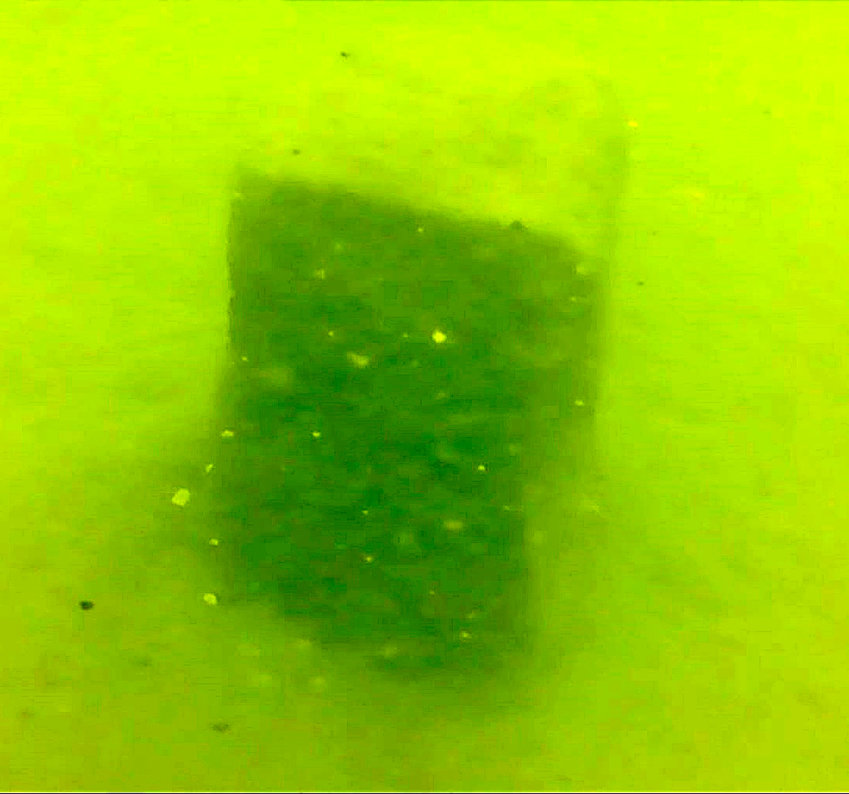

Fish were the only creatures to see the 160-year-old marker that divides the Tennessee and Kentucky border for years until it was discovered through a volunteer-based mission.
A surveyor, a fisherman and a diver found the hidden monument in early November, but volunteers had searched for it since 1990.
Stone #46 sits at the bottom of Dale Hollow Lake.

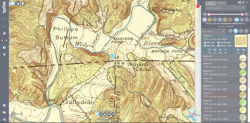

The 1929 quad map was the last quad map to mark the stone's location.
Dale Hollow 3.jpg (189.63 KiB) Viewed 13015 times

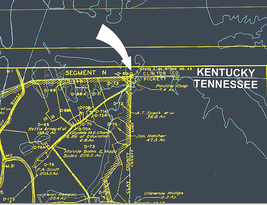

Charles Whittenburg used the 1942 United States Army Corps of Engineers map to verify the stone's location.
Dale Hollow 4.jpg (250.31 KiB) Viewed 13015 times

The original U.S. Army Corps of Engineers maps for the land acquisition of Dale Hollow Lake, which was created in 1943, clearly labeled stone #46 next to a popular trail.
Prior to 1990, surveyors could only use quad maps, which mapped elevations like mountain peaks and rivers, and there was no map archives easily accessible. In 1929, the quad map showed the stones' labels, but in 1959, the map revision removed them.
"Now we have the ability to pull up a map with stones and match it to a proximity of where a stone should be," Whittenburg said while clicking through multiple years of maps on an internet archive.
Digitizing the maps and orienting them to the two stones he found based on the marked terrain, Whittenburg was certain the missing monument was almost 30 feet underwater at what is known as Cook Pass, which was once a high traffic wagon road.

Within five minutes, he gave a thumbs up.
"I actually came upon this big stump and thought 'well the scan saw this stump and thought it was the stone.' So I swam over to the stump and four feet on the other side of it I saw the marker," Waters said.

Next to the stone, the video showed the hollow stump of a witness tree, which a surveyor would have marked using the cut tree method to reference the stone.
About two feet of the stone shows above the lake's bottom due to erosion. The men plan to return to the site in the spring to clean the stone and photograph the engravings.
The monument should have TENN on the south face, KY on the north, 1858-9 No. 46 on the east, and miles from the starting point of the Mississippi River on the west.
