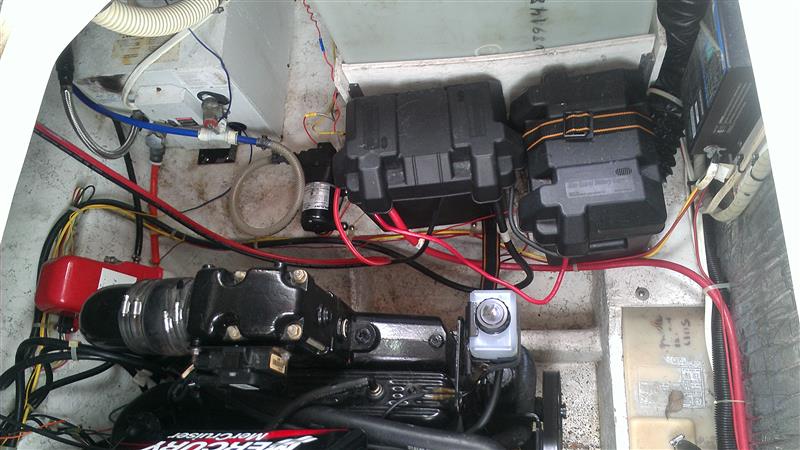

Getting ready to replace 4 batteries on my 2000 2655.
Really wish I knew how they were wired but I guess I will just watch for a normal battery and put a normal in its place for the start battery and then the other 3 I would guess will all be Deep Cycle. (can't remember what is under the lids. lol)
Here's a pic of my bilge/batteries
Overall

BTW, those look to be 24 series battery boxes, not 27's.

Looks like someone has added an extra battery on each side to the originals that your boat came with, probably because the smaller batteries you have do not have enough capacity for the way the boat is used. You like to spend a lot of time coved out. A better way would be to replace them with group 31 deep cycle batteries but you will have to change out all the battery boxes. I would stay away from interstate batteries (I have found that they contain less lead than their competitors, ie. their group 31 battery weighs less than many competitors group 29s. The problem is that most of the 12v "deep cycle" batteries you will find are not truly "deep cycle but a combo battery. Most of them do not like to be discharged less than 50% which can result in decreased life. If it were my boat (and I actually did this), I would dump the 12 volt batteries and replace them with 4 6volt golf cart batteries. Two per side and you can use your same set up and boxes. You will need to change the hookups between the batteries from parallel to series to get to 12 volts. You will get a true deep cycle battery set up that has plenty of power to start your engines (either bank) and can be discharged below 50% and not hurt the battery. My average battery life went from 2-3 years to 7-8, and I always had enough power to spend many days in a row at anchor with still enough power left to start the engines (two big blocks). The only downside is that you will have to check and fill the batteries more often (once per month in my experience)

Look at the Sears Diehard AGM's. They are nice, heavy, but nice! I replaced my starting battery with one of the 31M's that has a capacity of 100 Ah, a reserve of 205 minutes, 1150 Cold Cranking Amps and weighs 75 lbs.! I paid $229 on sale and the normal retail is $279. My stereo head unit is the only stereo item hooked to it. All the other amps and such have their own battery bank which are Optima Blue tops in the 31M size. I will replace the Optimas with Diehards when they die.
