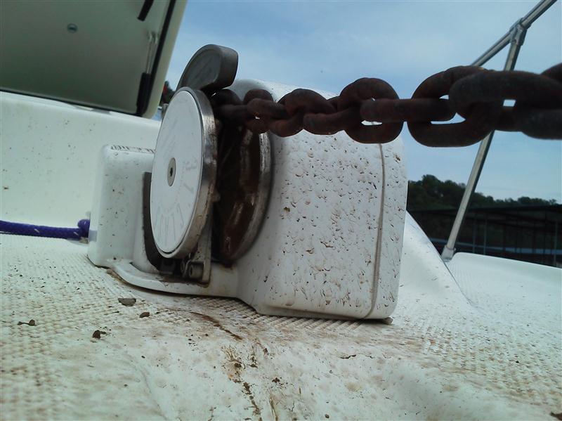

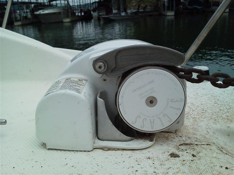

Can this Windless use rope and chain or just chain?
IMG_20120617_145237 (Custom).jpg (66.3 KiB) Viewed 19760 times
IMG_20120617_145256 (Custom).jpg (70.96 KiB) Viewed 19760 times
...and yes it DOES get the gelcoat pretty nasty every time I use it. (maybe that will stop once it gets used more often?)

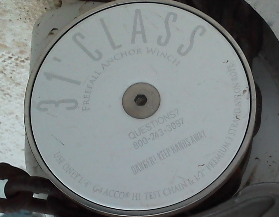

Look closely and it says use 1/4" G4 ACCO Hi Test Chain and 1/2" premium 3 strand Nylon rope.
Does that mean it WILL pull the rope up as well or is the rope for something else. I'm pretty sure that is a dumb question and that the rope is ok too but before I do anything I just want to make sure I don't get myself in a bind.

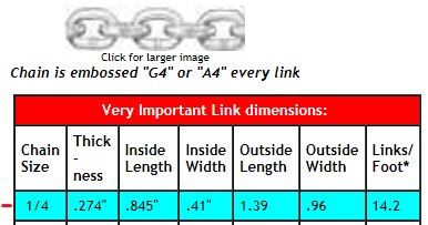

Another question, if I go with all chainis there a substitue to 1/4" G4 ACCO chain? Would any 1/4" x whatever length/width that the chain is be ok or is there even other chain out there that meets that exact size? I know there is all kinds of 1/4 inch chain but most chains I have looked at have either been shorter or wider and I'm sure that would not work.
Re: Windless
From this site - http://www.1st-chainsupply.com/chain/g4 ... _chain.htm
Windless chain.jpg (34.67 KiB) Viewed 19759 times

OK, first of all.... Windlass, with an A.
It does say right on the side of the capstan it takes a rope to chain rode. It is also not a free fall type windlass. It is a power down, power up windlass.
You can purchase a rope/chain rode already properly spliced. It says 1/2" rope right on it.
Personally, I would not fool with an all chain rode for a 27' boat. Too heavy and probably not necessary.
Once you get decent galvanized chain running through that thing again, all thet rust staining will cease.

Re: Windlass
That helps.
Windlass WindlAss WindlASS. lol ok I got that.
Where do you see that on the capstan and what is a capstan? :P
But...
The wheel in the pic says Free Fall Anchor winch :P
Thus I thought it should be able to free fall. Figured maybe there was a button sequence or something. Maybe down for 10' and let go or down for 10' and then hit down one more time or something weird.
.... and if I remember correct I don't think the Kansas SeaRay had a winch on it. As for the DC one I pulled up IMG-20120512-00312.jpg and I can't tell if that is a VERY low profile Windless or just a cap to the rope locker. There is no wash down host etc. :P (But it did have a remote spotlight... ....and seats that were falling apart. lol)
